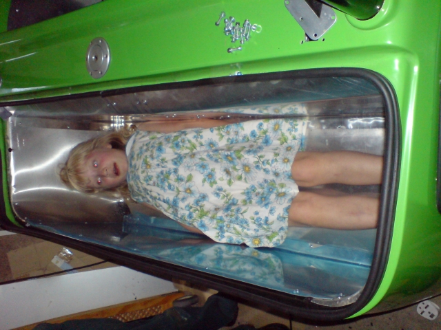

boot (extra seating potential):

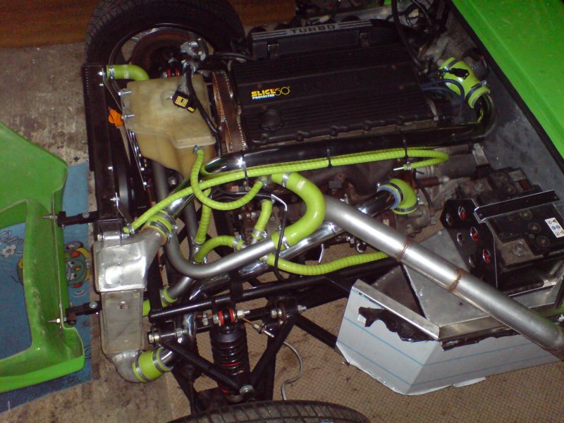

Rover 2 litre turbo power:

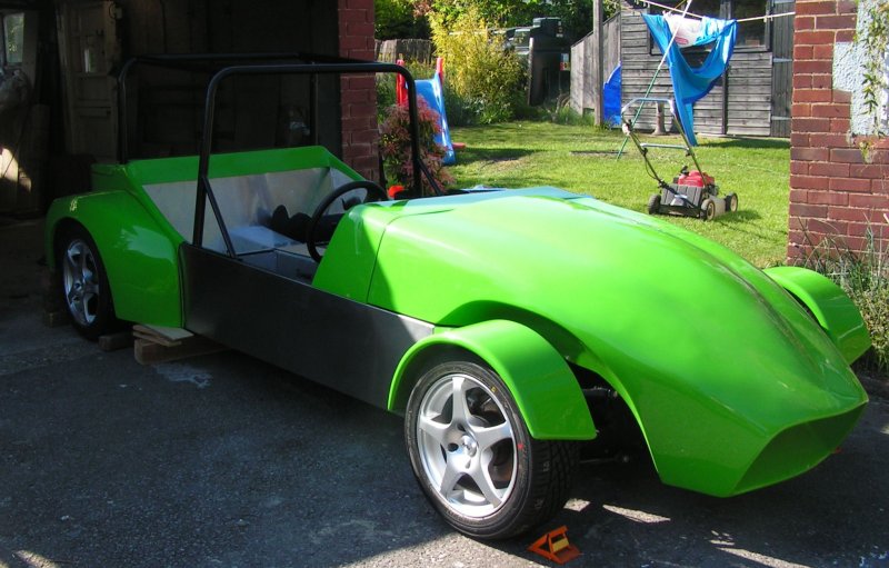

outside (before the interior went in):

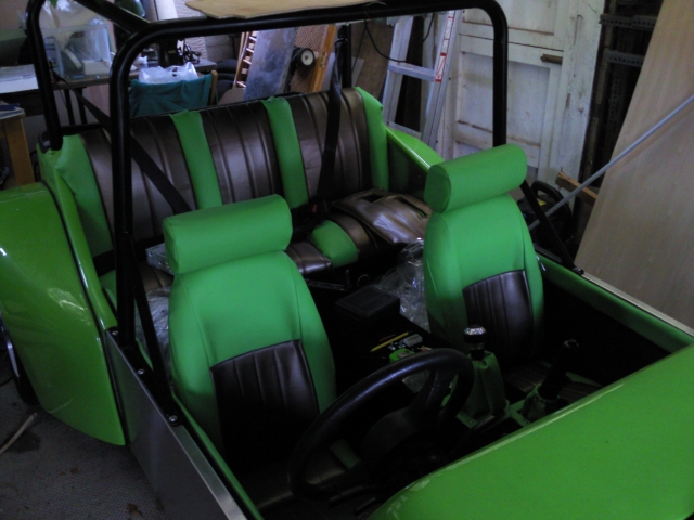

this is all I've got online at the moment, but it's going through as a 5 seater (and SVA were fine with that !) and has more legroom in the back than any production car I've been in.
