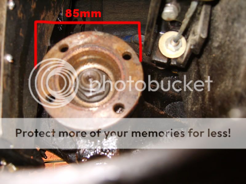

Anyway, point 2:
While talking to the knowlegable guy I mentioned the size of the flange on my diff being 85mm:
I'd always assumed it was a typical english live axle/diff under there but he says nope, much smaller and weaker but wasn't sure what it
was off, anyone have a clue what it may be off?:
(crap pic, but all I could find till I take more later if needed )
Any help appreciated!

The English axle has two different flange sizes, you have the smaller one (same as mine). They can be changed, but you should set up the pinion
bearing preload using a new crush tube if you do this.

Ahh I see, if thats true I'll be much happier, thanks.
Is there any advantage swapping for the bigger flange?
The guy suggested that as my flange is small it was probably an 1100cc escort van axle or similiar and hence too weak for 180 odd bhp which is what
worried me.
I know nothing about axles
Ps. are you sure yours is only 85mm across too?
