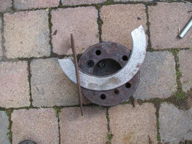

posted on 18/7/09 at 04:23 PM |
LCB strikes again! Cheers lads, you were all spot on. Disc came off alarmingly easily, eventually followed by the bell! Picture for general
amusement:

How many miles did you drive with those CD's
They look a little bit below the minimum thickness
[Edited on 20/7/09 by t.j.]
posted on 20/7/09 at 08:31 PM |
funnily enough the other side is barely worn. No idea whats gone on, but ive had the van for 40k miles so its definately me!
DarrenW
posted on 21/7/09 at 09:42 AM |
Well done Joel. I was just going to post about how i got mondeo discs off using the angry grinder method. Had a friend with a saab who had to do the
same.
It it the near side that is worn to excess? Maybe something to do with rubbish on side of road getting between disc and pads more often, perhaps the
caliper slide is sticking on that side. I gues you would have noticed excessive pad wear though before now (unless you were running metal to metal on
that side before changing).
[Edited on 21/7/09 by DarrenW]
