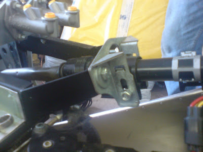

can't get fifth gear with the standard steering wheel and gearstick
the original bolt no longer secures the steering column, its far too long (the bottom bolt on the column in this picture is a complete bodge job with
a series of spacing nuts and a shorter bolt)

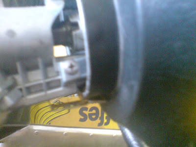

this photo appears to have focused on the box behind, but you can just about see that the steering wheel is up tight against the wheel lock
mechanism.. cue grinding noise when the steering is operated and metal shavings in the footwell

Well the easy one to fix is the steering grindign issue... you're missing a part!
The self-cancelling unit is missing. That will space the wheel out by 20-25mm further and cure grinding.
It's a plastic bush with 2 notches, one sticking out the side, one sticking into that notch in the back of the wheel.
About 20p from breakers.
As for first picture, most people chop the gearstick down... so that's not really a massive problem either.

You could just bend the gear lever a little to the left
not sure of the rest without closer inspection

cheers james + mookaloid, not sure about bending the gearstick might make for an odd feel?

see the little buldge in the gearstick? theres a rubber bush inside there, and the stick inside is exactly the same size as the threaded bit the gear
knob screws to.
do it
i did mine, and my gear lever is like changing gear with a toggle switch lol
or smaller steering wheel/don't use 5th gear
