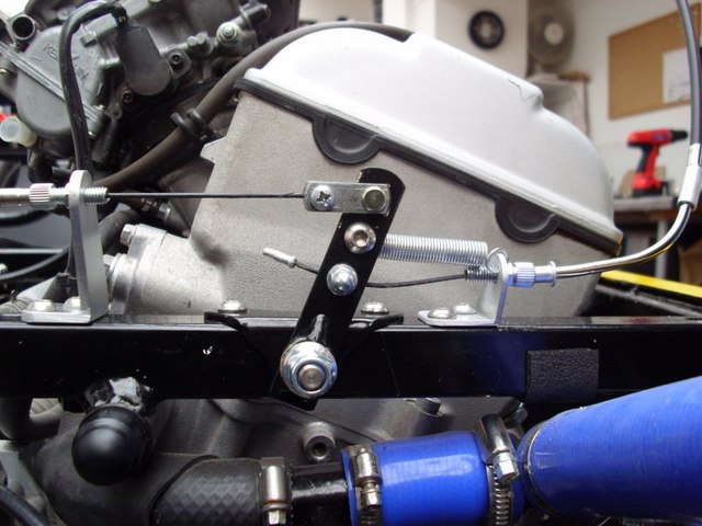

I'm trying to work out how i can get more travel for less movement on my throttle pedal.
as you can see in the pic, it's way forward(only way i can get full throttle) due to the cable being close the the pivot point, no room to lower
it due to the chassis bar.
anyone got any ideas how i can get lots of travel for less movement, maybe a pully system? or something on the throttle body end.
cheers
john

Shorter lever, or smaller diameter quadrant on the other end.

Right, this is where I need to draw a picture but I'll have a go with with words....
How about a bracket bolted to the engine side of the bulkhead that protrudes about 2in or so. On the end is a pivot with a lever. Connect a pushrod
from the throttle pedal to the lever about an inch from the pivot and then connect the cable to the lever about 2in fron the pivot. This will double
the travel of the cable for the same pedal travel, but will of course make the pedal stiffer- theres no free lunch.
That probably made no sense whatsoever, but if it sounds like a goer and you need a picture let me know.

That did make sense, sounds like a better idea than a pully system as it will be rigid.
ETA
and making it stiffer might be handy to,due to it being very sensitive with the light cable/pedal
great ideas so far guys muchly appreciated

It looks to me as though it wouldn't be a major job to take out your pedal box, then the simple answer would be to remake the throttle pivot
higher up, and that would only involve you in redrilling the bulkhead to give access for the cable. Shorten the top of the pedal, and lengthen the
bottom, but keeping it high enough to clear the obstruction. You know it makes sense, :-) Cheers Ray

got the same problem overhere and i just ask MNR what to do about it, they have developed a new pedal with a higher pivot point...
Works a treat.. Daniel
