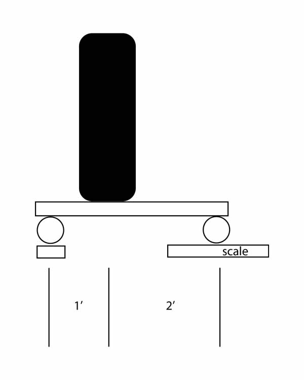

posted on 24/10/09 at 07:05 PM Reply With Quote
You can do locost corner weighting with a set of bathroom scales as well.
Use a bit of wood and two lengths of dowel as a lever arm to get your indicated weight below 300lbs (where most bath scales give up).
As pictured this will show half the actual weight on the scale, changing it to 1' and 3' will show 1/3 etc.
You'll need to space the other three corners up so the car is level.
Cheers, Ted
