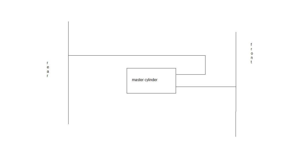

I believe your brake system will be fine, mine has one line to the back brakes and the other to the front.
It should be a split system but front on one circuit and rear on another is fine.

i only have one master cylinder
bit of a diagram how it is
