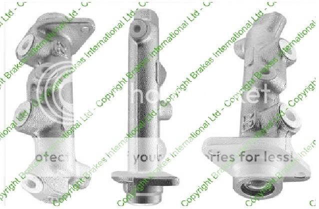

my master cylinder decided to drop half its contents into the footwell.
the problem im having is finding a replacement. its a sierra post 1988 bendix cast master cylinder where the end outlet points up. the only place i have found one is brakes int but they want £107!!!
does anyone know where i can purchase a new or referbished one for reasonable money
cheers ash
this is the picture of the type i need.

I found one just like that on ebay recently for £15 - it's on my car now

item no. 220506655649 on ebay now - is that the right one?

spoke to brakes int and ordered one from a mk2 escort rs2000.
the sierra one is 22mm bore and the escort one is 20.6. according to the the chap on the phone it should fit fine and make the brakes sharper.
