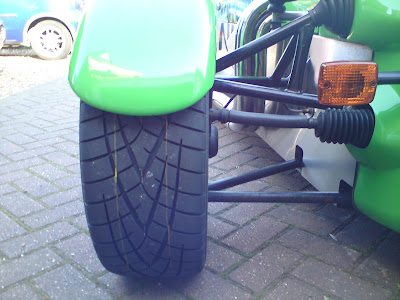

Xtreme Kermit
| posted on 20/4/10 at 07:49 PM |
My new boots
Toyo R1R - supposed to be near as good as 888 in the dry and much better in the wet.
All I know is I'm taking it easy at the mo and they still knock the socks off my old Yoko A539s
