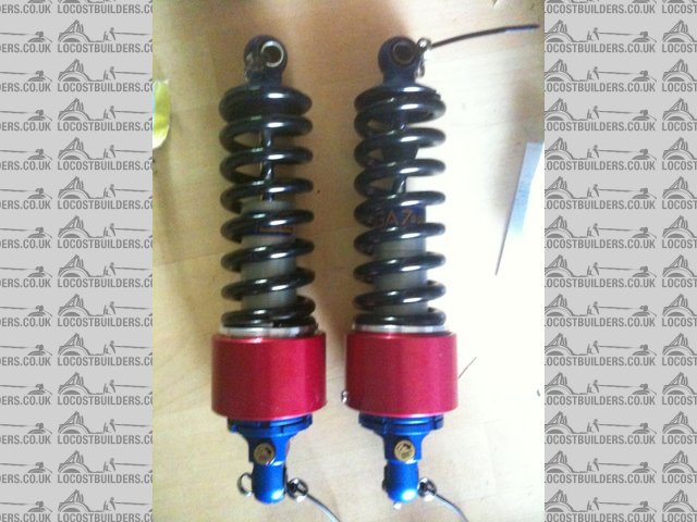

Received my shocks today, the rams yesterday. Ordered springs from faulkner, delivery Monday.
Waiting for pump.
Probably not going to fit for a while because I want to go to Newark (possibly the Monday Stoneleigh).
I'm working 10 nights straight.
Anyway enjoy the pics!

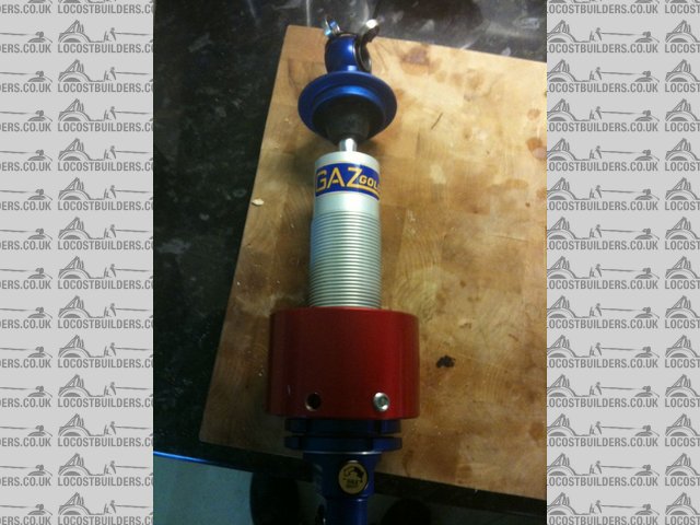

| posted on 22/4/10 at 08:56 PM |
how do they work? is the red thing the hydraulic cylinder? so it just pushes the spring away from the seat?
looks good. might think about adding something similar to mine at some point. its going to be very very low with the front bumper on...
Yes it lifts the spring only so when fully retracted there is a solid platform for the spring to sit.
The only limit is the extent of your shocks, so you will have to ensure you can extend them that far. Shorter springs will be required too. My
17" shocks sit at around 14.5" and will take 8" springs with my set up.
Apart from Ramliftpro and KW suspension in the states there are no UK suppliers.
I'm going to try and get them made over here as cheap as I can and supply the pumps too.
I already have the pump costs, just need to get quotes for making and supplying the rams. I also want to ensure that they are UK standards, easy to
get new seals and make sure the pipe threads are easy to obtain.
I'll supply one size to fit a 2.5" spring with adapter ring to fit 2.25" springs.
If anyone has a shock for 2.5" springs let me know the outer diameter of the shock body please.
Any opinions on how many wheels you guys want to lift? 2 wheel or 4 wheel kits?
I get the impression most cars will just raise the front.
I'm putting a 4 wheel kit on the MotaLeira and a mate is going to fit a 2 wheel kit to his Diablo replica.
I'm also looking for a resevour supplier if you spot one!
[Edited on 23/4/2010 by nitram38]

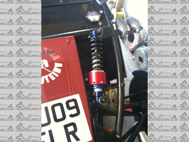

I got a couple of hours in changing the front shocks out. No hydraulic connections yet. I want to test drive it tomorrow to make sure the
springs/shocks work properly.
The car feels ok when I jump up and down in it but it needs a proper road test.

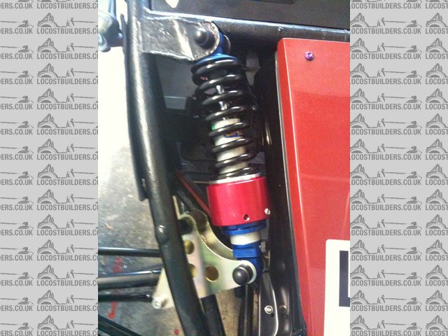

| posted on 4/6/10 at 02:59 PM |
Rear rams and shocks fitted today.
Plumbing of pump still required.
The main thing is that my springs/shocks work as they should.
