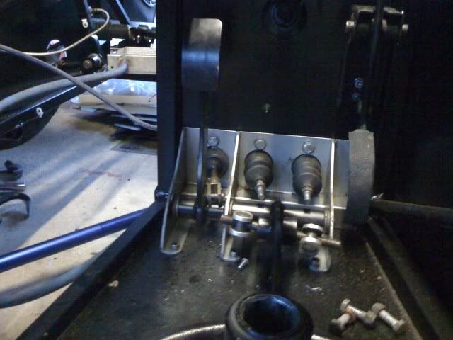

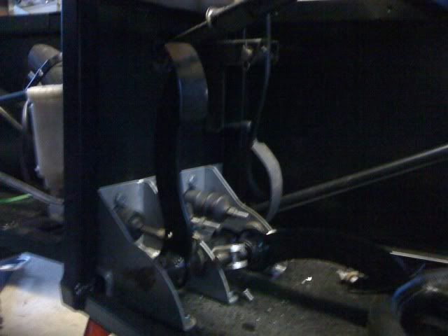

the problem i have is mounting the switch
i have floor mounted pedal box so cannot fit it where it is on the front as omex want,
if i fit it on the rear they dont have enough travel on the switch, it will max out on the switch before the pedal hits the stop if that makes sense,
trying to get my head around it

Can you fit one at the clutch lever end of things ?
eta what about a n/c switch ? That would be quick to ?

normally closed, fitted so your pedal holds it open, the moment pedal is pressed it closes itself, would be very quick, could be floor mounted on a small striker bar ?
beaver34
posted on 7/5/10 at 07:12 PM Reply With Quote
yeah sounds good, im off to get some pics of the setup see what you think
