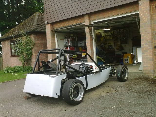

I've got them on 13x5.5 on the front and they aren't really ideal. The sides of the tyre are pulled around so the contact patch isn't flat. I've got them on 8s on the rear and they're much better. They're run on 8s on Formula Renaults.
phelpsa
posted on 11/6/10 at 11:43 AM Reply With Quote
16/53s on 13x5.5s:
and on 13x8s:
