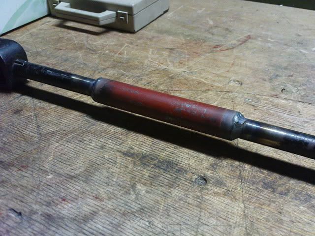

If you're on about the steering shaft I used some pipe I had kicking about as mine was 15mm O.D.
The pipe is 14.9odd I.D so I spun a 15mm drill through on the lathe just to clean it up a bit, then it went on with a slight tap, and I tigged the ends up.
Like this
It's 3.3 wall seamed, so a bit thicker than required but I had it there.
