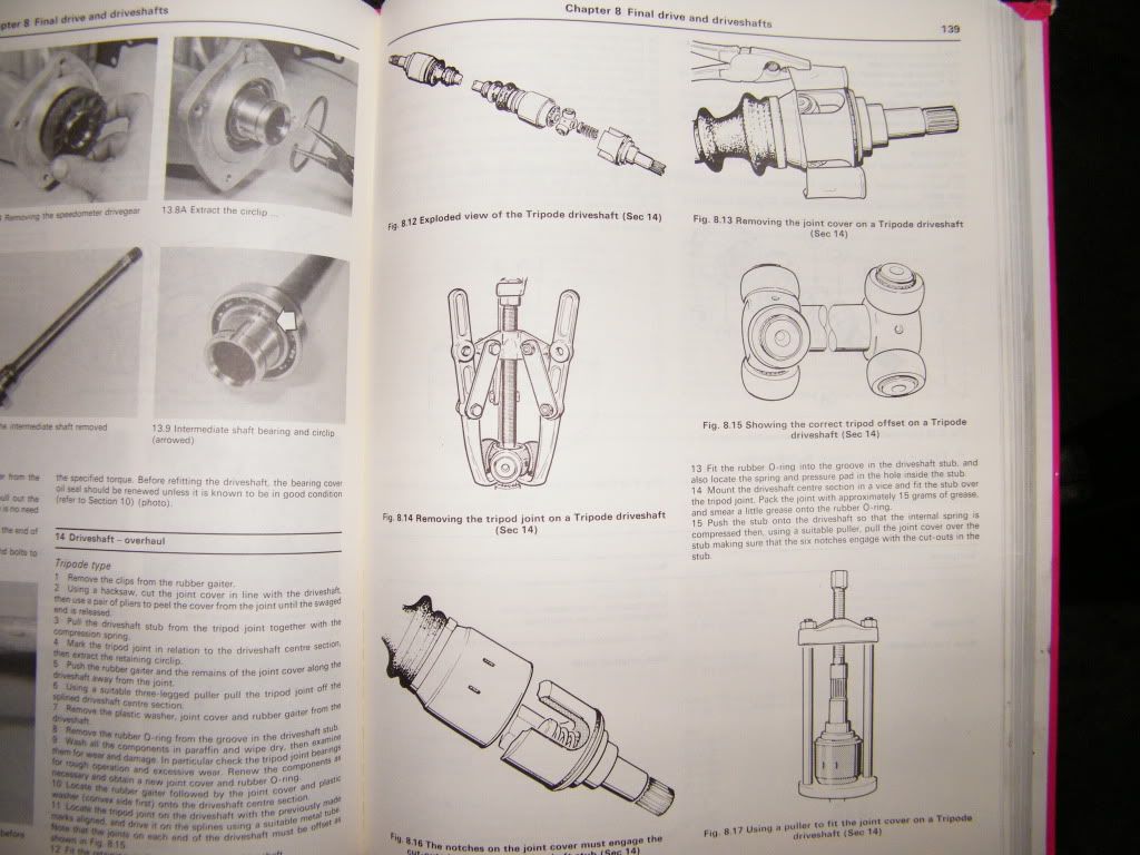

pstirz
posted on 8/9/10 at 08:14 PM Reply With Quote
I think it a push in, there is no bolt
mcerd1
posted on 8/9/10 at 08:24 PM Reply With Quote
the bolt-on ones have 6 small bolts at each end to hold them onto flanges on the diff / stub axle
or push-in ones (looks like you need a new metal cover bit to strip them completly
