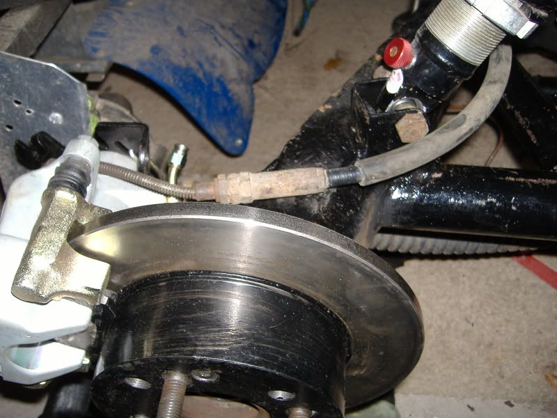

current project has a wilwood disc conversion that was designed to take a drum sierra to wilwood cheap light ally sliding handbrake rear caliper.

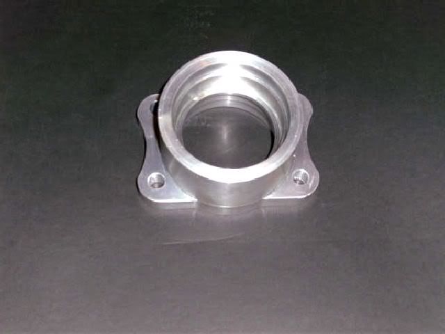

this is the type of rear bearing carrier i want to use.
they are an alloy copy of the sierra cast iron bearing carrier but without the lugs

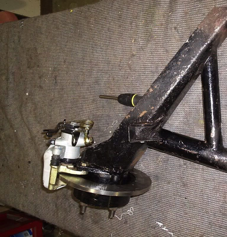

if i continue to use my current wilwood ally rear calipers (not powerlite)
i will need an adaptor bracket, caliper bolt holes are 90mm apart.

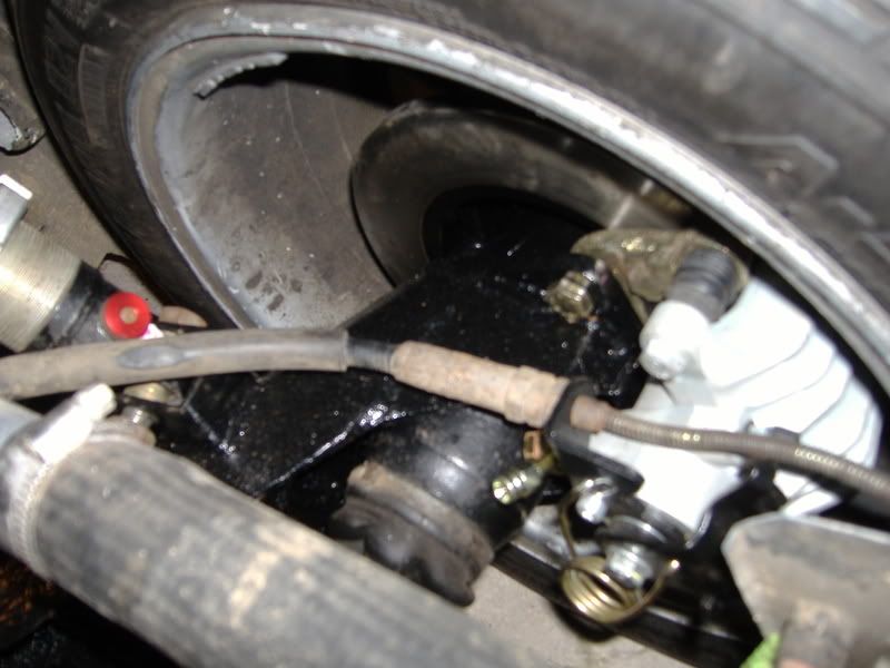

(assuming thats your current setup in the pics) I don't know what discs you conversion kit is based on, but I think the sierra ones are biggger
have a much shallower bell in the middle - this can be a problem with small wheels I'm told (e.g. 13"

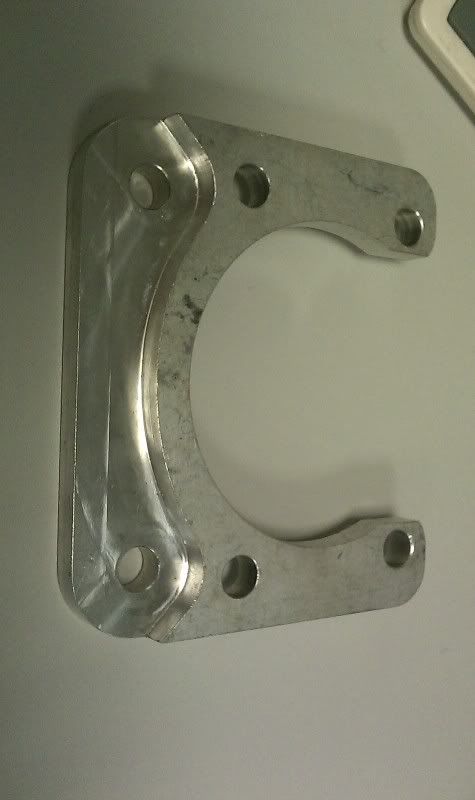

had a scout round the workshop last night and found these ally brackets that came with the original RalDes sierra drum to disc convesrion kit
these, plus the autograss hubs should be nice and light and solve my problems, forgot id even got them
