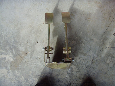

| posted on 24/11/10 at 09:03 AM |
Dan
I've got a floor mounted, cable clutch, balance bar pedal box sitting in a box somewhere - let me know if you're interested and I'll
dig it out and send you some photos.

| posted on 30/11/10 at 12:23 PM |
Hi . Sorry I forgot to post photos! Try here -
http://lh6.ggpht.com/_wMf3_sZh240/S3vGxfP1yNI/AAAAAAAABPM/eTmEkMlusBU/s400/SNV30564.JPG
