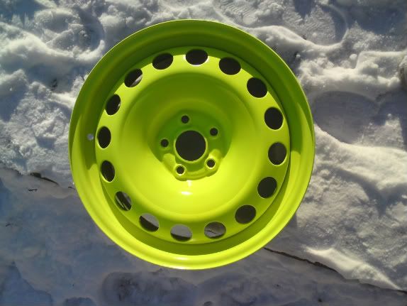

I've bought Vredestein Snowtrac 2s which should be here tomorrow or Wed and they are going on these    :
Can't wait!!!
EDIT: they are 16"s and yes they are fluorescent yellow, ultra bright in the sun
[Edited on 29/11/10 by Stott]
