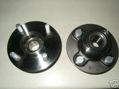

I guess what I’m after are some thoughts on the basic design, I’m thinking 44.4mm by 2mm tube, a steering arm cut from 50mm by 25mm by 2mm box and two
plates to sandwich the lugs of the calliper. There are three turned elements the two ends threaded for either 12mm or ½” bolts for rose joints and the
axle to take a simple hub like these from a micra rear.
Equally Honda civic’s look nice but I want to get a couple of different ones to find a size/weight that works best. As usual what do people think?

I’m thinking I’ll get all the turned bits custom made, the thing I like about the micra and civic rear hubs is that they have a one-piece sealed
bearing unit so they go on a parallel axle so should be simple to make.
My thinking is that I can then use the same make front hub units to make my rears so same pcd etc.

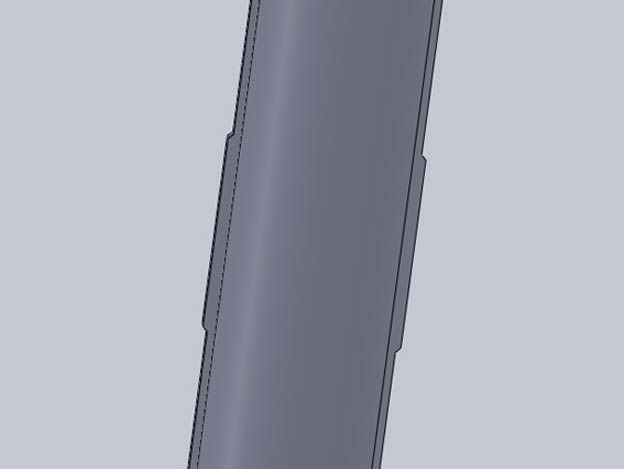

I did have a similar concern, not because a hole has been cut through the tube because I deliberately designed the axle to be quite wide at the point
passing through the main tube and welding (or brazing) this in will replace the strength lost through cutting the hole. My concern was that I didn’t
want the axle to be too thin walled, equally I didn’t want it to be solid as it passed through the tube. The differential of thickness was what I
didn’t like.
One solution I came up with was to externally butt the tube i.e. start with some 3mm wall seamless tube and turn the ends down to my chosen wall
thickness leaving more meat in the middle where the axle passes through, see pic:
I’m not concerned with the steering arm because this will be designed so that the weld area extends to about half the circumference of the tube.
Once I’ve fully dimensioned the model I’m going to try a bit of structural analysis on it, which should be interesting !!
[Edited on 24/12/10 by orton1966]
