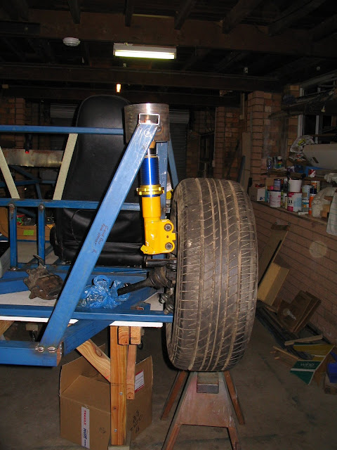

Well, that's what I'm building (middy with wishbone front and strut rear)
For further "endorsement" of the layout, look no further than the Lancia Stratos.
I think it's a very rational way to re-use common donor drivetrains without inventing a rear wishbone layout (and finding room for it around a transverse engine).
