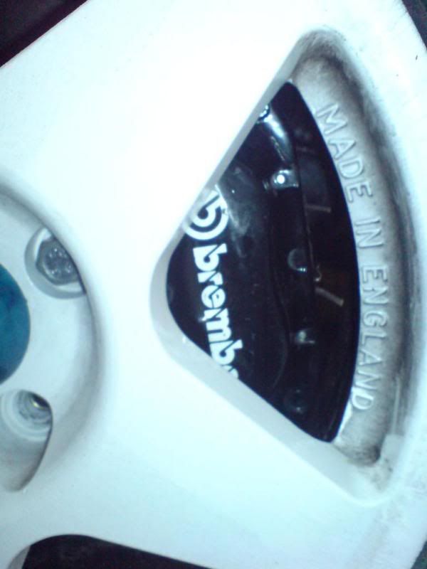

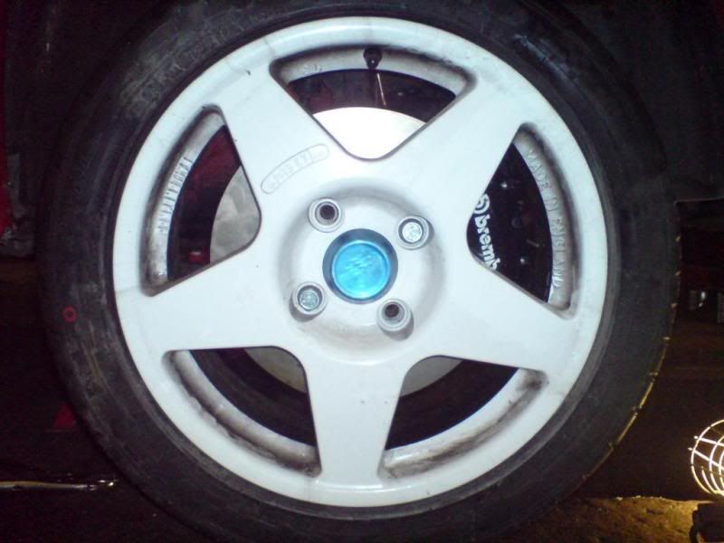

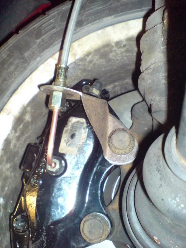

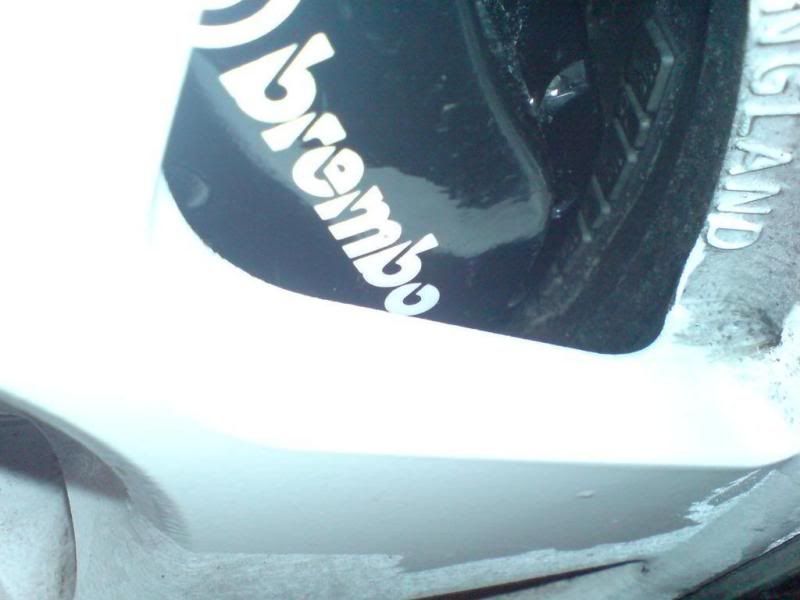

Rallye_Mark
posted on 19/1/11 at 05:40 PM Reply With Quote
Hope these help but as you can see quite close to the alloy.
b14wrc
posted on 19/1/11 at 07:54 PM Reply With Quote
Thanks. I get a good idea on how close they are. Good job you did on getting that to work. I have actually been looking at the coupe disc, which fits the the cortina hub, and tried a 307 15" steel wheel on, with the right off set I think it's "do able"......
Those compomotive wheels offer probabily the best clearance like, I was hoping to get team dynamic protege 1.2's like on my GTfour. They also offer lots of spoke clearance.
