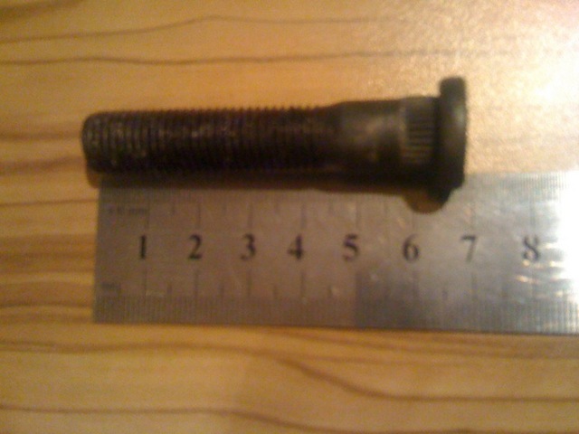

Hmmmm... seems that my existing ones are about as long as you get (65mm)!

Thanks V much Rich! I'd probably want a little more, but 70 is still better than 65!
there 70 is measured overall length, your 65 looks to be under the 'cap'... probably not much in it
| posted on 18/1/11 at 09:12 PM |
It's just the shadow in the photo Dino. The original studs are 65mm in total.

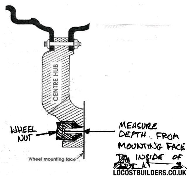

what are these one for / do they really need to be that long ?
this is how I measured mine up:
http://locostbuilders.co.uk/upload/2376_001 (Small).jpg

Fraid so! It's because of the spacers needed to get past the big Alcons!

how think are your spacers
I got away with 63mm studs on my 15mm spacers and really thick wheel ctrs....
I think dax sourced some long M12x1.5 ones for a group buy on TD wheels a while back - I could give them a call and see what they can get if you
