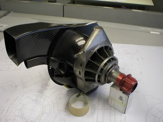

money no object...well
gavin174
posted on 18/2/11 at 08:52 AM Reply With Quote
you did say money no object!!

designer
posted on 18/2/11 at 09:07 AM Reply With Quote
That's priceless, a front upright/brake assembly supported by a used roll of masking tape and an old box!

gavin174
posted on 18/2/11 at 02:25 PM Reply With Quote
sorry it's all I had....
