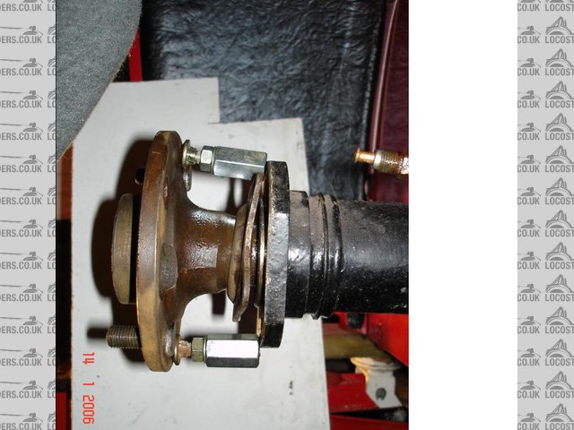

you've tried making a presss like this?
piece of studding connector, bolt and nut.
oph, and don't go hitting the tyre, not only is is cruel but it will absrob most of the force of the blow plus bounce the hammer back into yer face.
