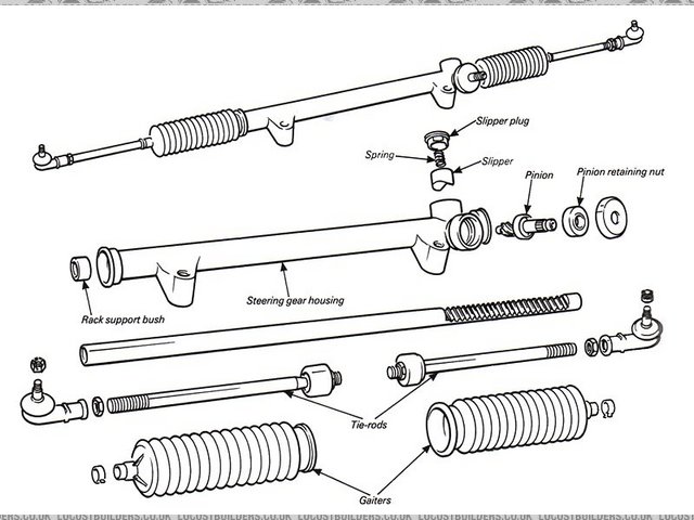

Your rack should look like this if it's a Sierra rack. Only shorter......
Phil
Hellfire
| posted on 4/5/11 at 06:09 PM |
A common problem with the Sierra rack is the pinion working loose. If you remove the yellow plastic cover, you should be able to tighten the pinion
retaining nut sufficiently to remove the excessive play.
Phil

austin man
| posted on 4/5/11 at 07:00 PM |
I tightened the slipper a little as well this is a rack off though and a pitta to do as the unit breaks apart easily
