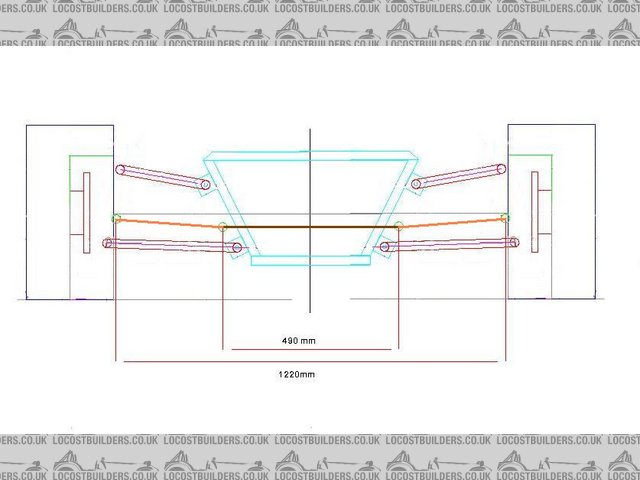

The Rack should try to keep parallel to the lower wishbones and the inner and outer pivots fall along the inner chassis mounts and upright mounts. A pic is a better way of telling you.
