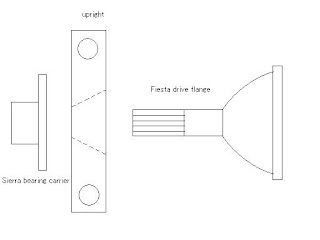

I'm trying to find out if you can use Fiesta drive-shafts with Sierra bearing carriers? I'm finding it difficult to get specific details
of drive shaft dimensions, flanges etc, but I want to make a simple rear upright and bolt on a Sierra bearing carrier. However, I want to use a
Fiesta differential and drive-shafts. Is this possible?

This is what I am trying to do:
Yes, I really need the bearing/driveshaft diameters! I believe the bearings are a standard size of inside diameter 105mm and outside diameter of
130mm. Is this correct? Seems a little big to me. I'm getting my figures from Tony Pashely's book but they aren't very clear.

What you could do is measure the outer diameter of the fiesta shaft, to see if it matches the inner diameter of the sierra bearing, if it does test
fit with all bolted up, if tight your might be good to go, if the shaft still wallops about after tightening up the nut you might needs a suitable
spacer turned up on a lathe.
And if the sierra bearing/hub, fiesta shaft combo is not the same you could install a custom set of bearings in the hub, to do this you need to find
a local bearing factors, and supply them with the O/D of the bearing taken from the hub, then give them the inner Dia (of the bearing you want, this
measurement is taken from the O/D of the fiesta shaft) this will provide a custom bearing(s) set to suit your application.

you would also need to ensure they are the same spline

Thanks for your help gentlemen. I like the idea of swapping the bearings out for the correct ones - seems to be the simplest solution.
