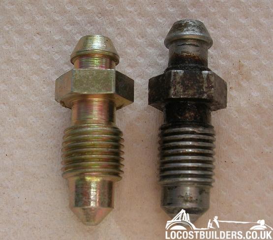

Ahem - Nipple problems
If you can get over your disappointment
Can't get new bleed nipples for my Sierra caliper, local motor factors (normally very good) gave me the one's (left) in the picture, old ones shown on right.
They wont even go in the hole the old ones came out of. Does anyone know the 'official' part number so I can try ordering that.

DavidM
posted on 27/6/11 at 10:43 PM Reply With Quote
They should be M10 thread. The thread on the right looks strangely knarled, as if it may be the wrong thread for the caliper, but was wound in anyway.

Davg
posted on 27/6/11 at 11:07 PM Reply With Quote
Yup agree wiff above.
You could stick a tap down the thread. Loads M10 ford nipps on the Bay. I would go for the stainlees ones advertised.
cheers D
ss1turbo
posted on 28/6/11 at 07:39 AM Reply With Quote
I wonder if someone's squeezed a 3/8 one in there...? Get the vernier caliper on it - imperial nipples have an imperial AF size as a rule, metric a metric.

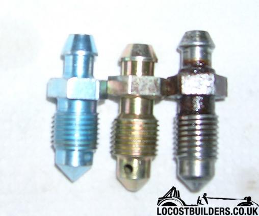

norfolkluego
posted on 30/6/11 at 07:19 PM Reply With Quote
Now I've got three.
Ordered some M10s off ebay, they don't fit either
So that's M10 on left, the motor factor 'Sierra' ones in the middle and the ones off the car on the right.
Now what I'm thinking is, I don't have Sierra calipers (I didn't build the car)
Poor picture, sorry

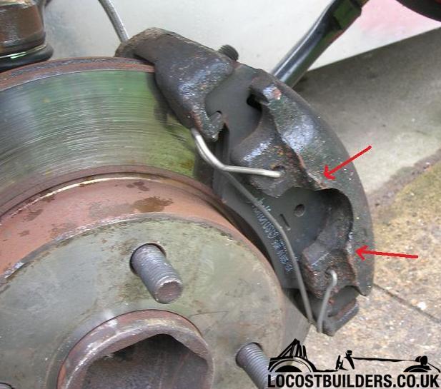

mcerd1
posted on 30/6/11 at 07:24 PM Reply With Quote
got a pic of the calipers ?
do they have any big numbers cast into them ?
[Edited on 30/6/2011 by mcerd1]
norfolkluego
posted on 30/6/11 at 07:30 PM Reply With Quote
Only one I've taken, not a good view
mcerd1
posted on 30/6/11 at 07:35 PM Reply With Quote
they do look like sierra ones (as much as I can tell from that pic at least)

adithorp
posted on 1/7/11 at 10:07 AM Reply With Quote
Those are Sierra front hubs and look very much like Sierra calipers. Certainly don't look like anything earlier that wouldn't have M10 bleed nipples.
The old nipple looks like someone has cross threaded a nipple in the caliper and daMAGED THE FIRST COUPLE OF CALIPER THREADS AND THEN EITHER (oops, cap lock) got the old nipple or a new one started on the right thread . Thats then damaged both the nipple and probably the caliper threads. Result is that the new good nipple won't start as the tread profile doesn't match the damage thread. You could try re-tapping the hole to clean up the tread but be carefull as it'll strip easily afterwards, or otherwise it's a new caliper.
