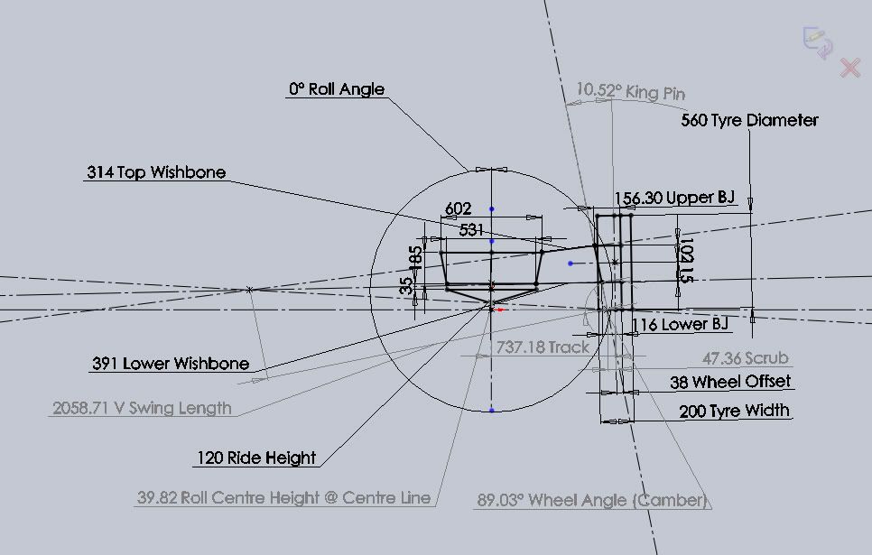

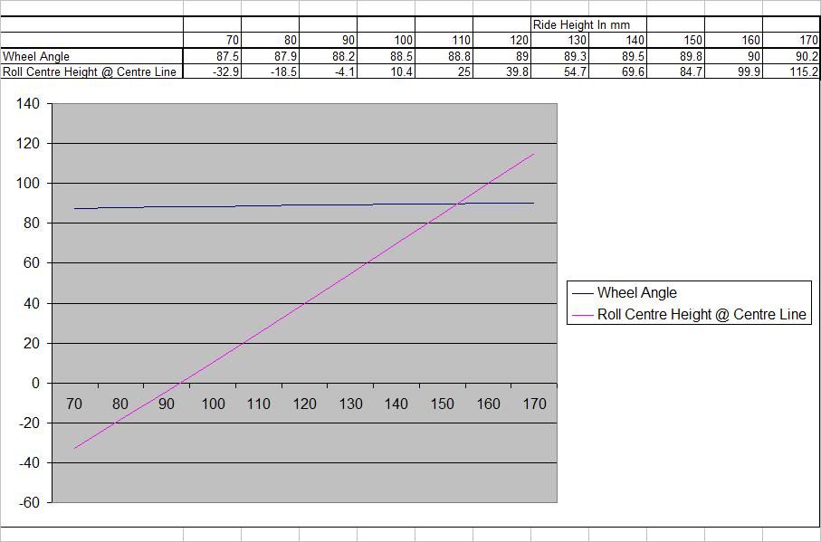

As information seems lacking I decided to model the rear suspension myself and share what I found. Firstly some assumptions, wheel size is approx for a 15” with 195 by 50 tyre but it will depend what tyre/ rim width you run. Track was originally set at standard Sierra approx 1468mm with the wheel vertical (zero camber) this increased by about 6mm when I set the model camber to 1 degree negative (book recommended initial set-up). As a ride height I started at 120 and went up and down 50mm from there. Below is the picture of the cad model and the findings for straight suspension bump rebound, I’ll do some roll figures and post these later

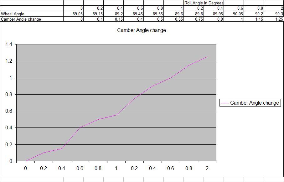

Camber Gain In Roll

Who knows? But I’m welcome to suggestions. On balance everything seems pretty good, the exception might be the roll centre movement, moving way beyond the amount of bump or rebound. Additionally shorter top wishbones would reduce the amount of camber gain
