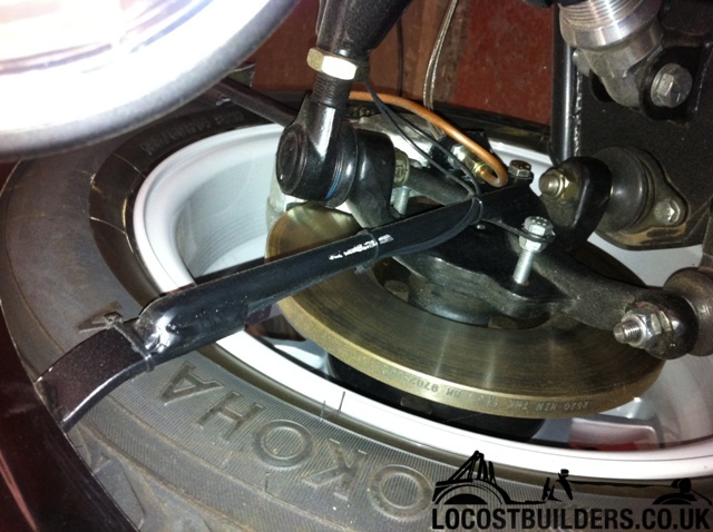

I've been warned if you are using M16 calipers where the flexi enters the caliper from top it may fail IVA, as the motion of steering the car may loosen the flexi entering the caliper.
So you will need a small piece of fixed pipe from the flexi to the caliper, see photo below.
If you are using Wilwood calipers you will be fine as the entry into the caliper is in a different location.
I maybe wrong but I guess I'll soon be told!
