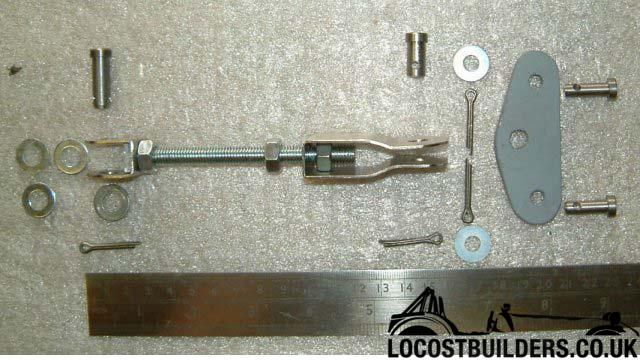

A bit of DIY bending and clevis pins - couple more pics in my archive under 'Handbrake'.
Cables secured using a blob of weld - didn't work too well - parted as I arrived for my IVA test...DOH!
Mark II securing was using the inner brass bit from standard electrical 'choc-block' connector.
HTH, Steve.
