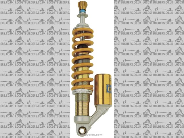

How Could I Adapt This Shock to Work?
I was probably just going to be selling on the BMW HP2 front shock that came with the rear I wanted, but it's a nice bit of kit and I'd be keen to use as much as I can from the bike.
So I got to wondering if I could use it (and another) on the front of the trike!? Thing is, the upper mount is designed for one of BMW's paralever doo-dahs, so would need some sort of 'collar' machined that would clear the adjuster and connect rigidly to a clevis-style assembly. Anyone got any design ideas?

What about using it in a leading link setup
http://www.hedinghamsidecars.com/Unit-Leading-Link-Forks.php

Have a look in here for adapted bike shocks...
http://www.locostbuilders.co.uk/photos.php?action=gal&user=SPYDER
Front shocks STM PHOENIX

monoshock front end is ideal for a 3 wheeler!
