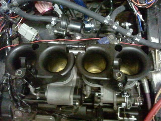

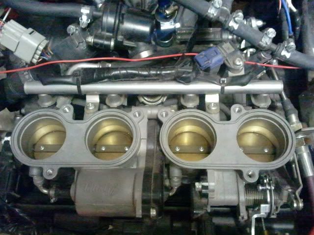

-matt
posted on 23/9/11 at 07:19 PM Reply With Quote
hmm, im not too sure how im going to mount the plate as the 08 T.B has the extra ?motor thats raised up.
like this:
The only way i can think of is to use these from the original airbox, cut the 2 brackets off, then bond the base plate to this?
so does anyone have any ideas on this?
cheers
Steve Hignett
posted on 24/9/11 at 02:59 PM Reply With Quote
Can you not use the OE airbox?
This would be my first choice..... However, I do have a sheet of Carbon Fibre/Kevlar Hybrid PrePreg that would be big enough for a baseplate (which could be easily cut by me from some Dims), and I also have a Pipercross Sausage Filter for sale...
