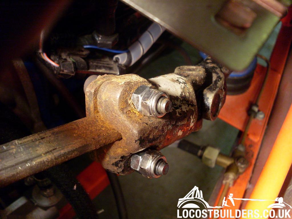

That's a NO NO! You must have a locking device on all connections on the steering column.
This was the most serious fail point of the 11 points on my IVA - the steering extension connection bolts used to have locking tabs on the heads of the nuts, but they had broken off well before I got hold of it. The plate underneath the bolt heads was still there, but there was just a vestige of the tabs left. He suggested either getting a new locking tab plate, or getting some longer bolts which went right through, and fit nylocs. This is what I did.
This is one of the places which, whilst it is unlikely to come undone, if it does, the results could be fatal.

OOps, just re-read your post, I realise you are talking about rack extensions, and not column extension - so ignore me!!
