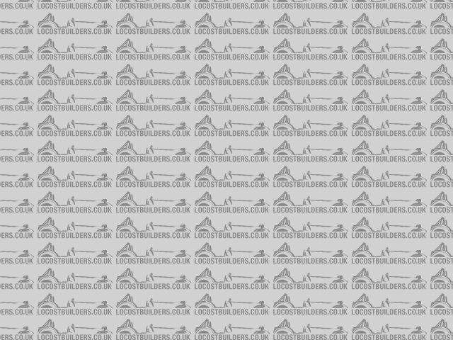

big-vee-twin
posted on 4/1/12 at 05:16 PM Reply With Quote
Alfa 157
[img] Master Cylinder and reservoir  completed
[/img]
