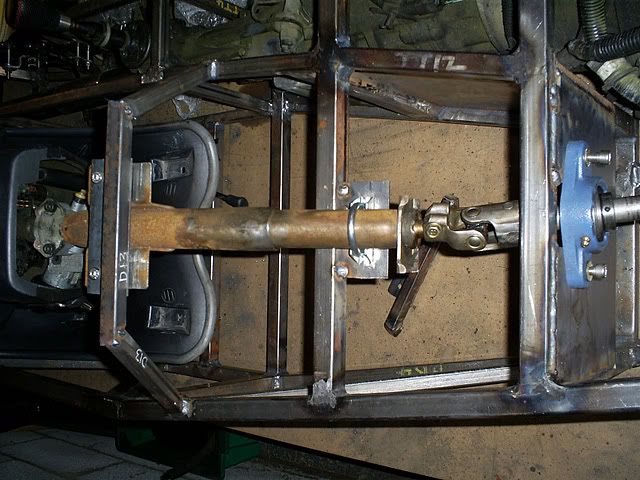

The reason for using 3 is I am using an MX5 steering column. It is quite a lot shorter before the first UJ than the sierra one.
The first UJ is before the pedal box. It will be supported with a bearing as it passes through the pedal box and at this point unlike the borrowed
picture the shaft will be perfectly straight.
After that it will be very similar to if I was using a Sierra column. I guess the steering feeling won't be affected as the uj will be
completely straight.
