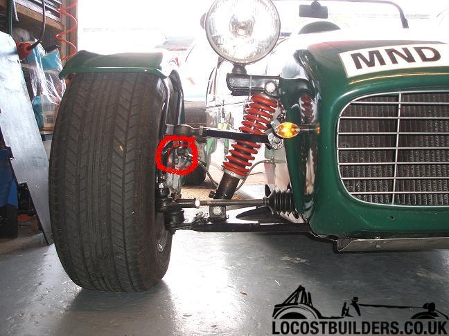

Any one know the size of thread on the transit drop link ?
Hi all
ive had the front suspension apart for a refurb,
and thought i had all the Nylocks i needed, but, the transit top link to the front upright has me stumped
Any one know what size thread it should be ?
I say should, as mine is baffeling me!

What size nut is it ? Mine is a 19mm nut and M12x1.5 thread I think, it's definitely bigger than M8 and M6.

19mm spanner fits it, but a 12mm mm nut does not, it looks like a fine thread,
but it should be metric??

Main thread is M18x1.5 metric fine. Taper arm thread is M12x1.75 std metric. Lower wishbone maxi balljoint is M12x1.25 metric fine. So don't get the nuts mixed up.

The top ball joint to hub carrier is 12x 1.25, ie a standard 8mm bolt fits the pitch exactley
the bottom ball joint on my maxi joint is 14mm x1.25, and this one was not affected, as its still has its castle nut and splitpin
