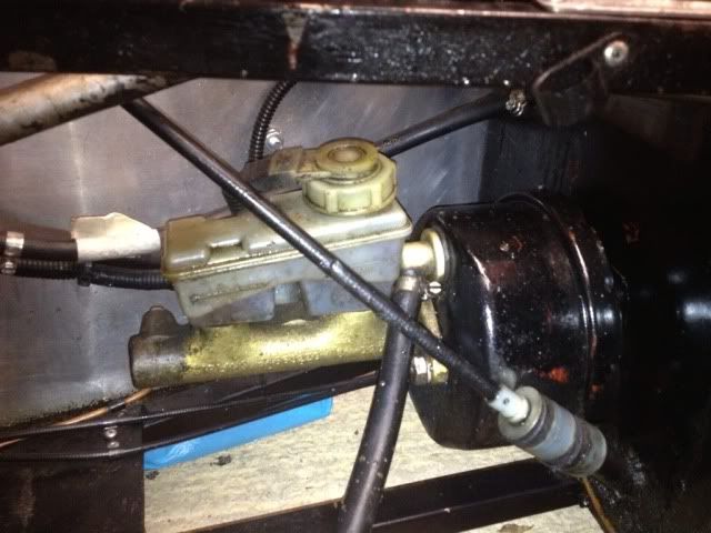

What BMC is this?
It's ford but that's all I know. It wasn't working but the servo was attached too? Any ideas?
SteveMX5
posted on 20/11/12 at 08:30 PM Reply With Quote
Looks like Cortina MK4 to me, but I have been wrong before
britishtrident
posted on 20/11/12 at 10:10 PM Reply With Quote
Yes Mk3 to 5 Cortina but most Girling master cylinders and servos fitted to medium cars of this era are pretty similar.

Thanks for that, any idea why the servo was connected? It certainly isnt servo assisted!

How do i tell what size it is?
posted on 21/11/12 at 11:59 AM Reply With Quote
Not sure why you think it shouldn't be, tbh the servo is a bit lame and not up to modern car standards. A quick way to test it is to start the engine, then switch off and pull the hose off, should be a loud hissing sound even hours later, non usually means a burst diaphram or knackered one way valve though I've never seen one that had failed
