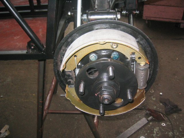

| posted on 13/7/13 at 06:32 PM |
quote: Originally posted by rusty nuts
Post some photos of your set up Andy.
My camera is crap, so sorry about the poor quality, this is the n/s rear drum, just took the drum off, have not altered anything.
HELP PLEASE!!!
| posted on 13/7/13 at 09:08 PM |
The adjuster mechanism is at 9 o clock on the first photo, difficult to tell from the photo but it may be the adjuster is not moving freely. I would
dismantle the brake shoes one side at a time , free the adjuster cam , reassemble and adjust, that way you have a one side to refer to in case of
problems Repeat for second side

renetom
| posted on 14/7/13 at 08:11 AM |
Hi
From your lower picture & with the cylinder at the top.
(as it should be) you have the offside shoes on the nearside
& viky virky.
The handbrake lever should be behind the shoe as you view it.
I'am surprised the auto adjuster works at all.

adithorp
| posted on 14/7/13 at 08:57 AM |
I agree with renetom, the adjuster and the handbrake lever should be mounted on the back of the shoes (between the shoe and back-plate) not on the
outside. You need to swap the shoe with the lever from side to side and re-assemble.
With the cylinder at it's current angle you'll also have to be careful when bleeding as it will tend to hold air in the top piston. Bleed
with the adjusters fully off (always should anyway) to try and reduce that.

AndyW
| posted on 14/7/13 at 09:03 AM |
the shoes had previously been assembled wrong by the looks and the adjuster faced the back plate when it should face out so you could not release it.
I swapped the top shoe from left to right and with some help from a nice guy on RHOCAR who had a picture form the factory I now have my set up like
this
The pedal seems firmer than before and the handbrake come up three clicks (out of seven) and I tried to rotate the when with the handbrake on and
could not!
Hope its fixed, going to run the car out of the garage today and up and down the drive and try the pedal to see if its actually fixed it.
**One other thing, as my cylinders sit and 3 o'clock on the left and 9 o'clock on the right should the bleed nipple or brake hose be at
the highest point?**

renetom
| posted on 14/7/13 at 09:19 AM |
Not the same as Sierra, but it should work fine now.
Bleed nipple at highest point.
[Edited on 14/7/13 by renetom]
adithorp
| posted on 14/7/13 at 09:54 AM |
That looks better.
Bleed should be the highest. There will be a possibility of air sitting behind the top piston though. Bleed with the adjuster fully off to put the
pistons as far in as possible and reduce the space the air could be trapped in. If that still leaves any spongyness, bleed it with the drums off by
opening the nipple, pushing the pistons in with screwdrivers, shut bleed and then let the pistons slowly return, open bleed and repeat; That should
expel the trapped air.
