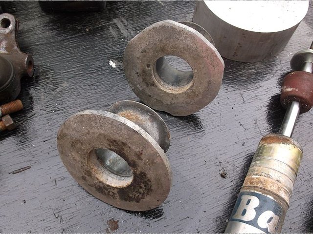

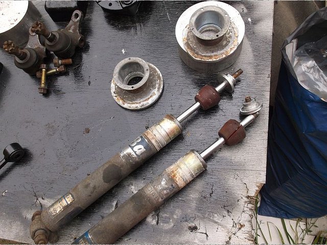

Thanks - I'll bung him a mail later - meanwhile , heres the offending shocks.....
The spring seats arent threaded , they just press on - so should be easy to re-produce . Not so easy is the split bump-stop rubber and perished boots.....

MikeCapon
posted on 20/7/13 at 10:28 AM Reply With Quote
Clarence will have the bumpstops. Failing that I have 20mm bumpstops for 16mm rods. You can use them singly or in pairs. As for the boots I ca't see any in the pics?

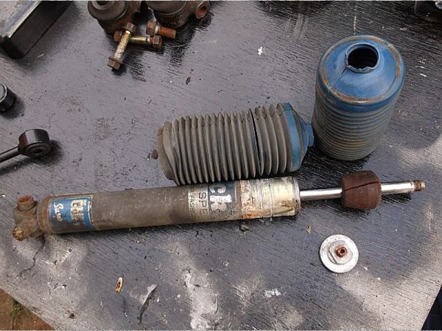

Heres another picture - of the gaiters and knackered bumpstop .
The bumpstops are 38mm long if that helps .

Minicooper
posted on 27/7/13 at 11:17 AM Reply With Quote
Any coil over bump stops will do the trick, doesn't have to be ohlins originals does it?
clairetoo
posted on 27/7/13 at 11:23 AM Reply With Quote
It doesn't have to be Ohlins - but I cant find anything the same size anywhere - biggest problem is these have 12.5mm damper rods , while 14 / 16 mm seems to be the norm .

Minicooper
posted on 27/7/13 at 11:38 AM Reply With Quote
Just checked my protec coilovers, the damper rod is 12mm, worth a call maybe
MikeCapon
posted on 27/7/13 at 12:45 PM Reply With Quote
ProTech 12mm bumpstops will go on easy. I've squeezed them onto 16mm rods in the past.
