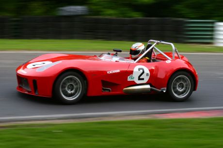

I agree with Werner the front looks like the fulcrum, rest of the body isn't do dissimilar to an aero version of the La Bala
![](/galpreviews/P1040292.JPG) ![La Bala](/gallery/P1040292.JPG) La Bala

The other references to the Fulcrum and La Bala - its vaguely similar but that bit of the Fulcrum looks ok.. - and La Bala, I think its plenty
different (but then I would!) and a shape like that is mostly dictated by layout and trying to end up with a svelte body.
