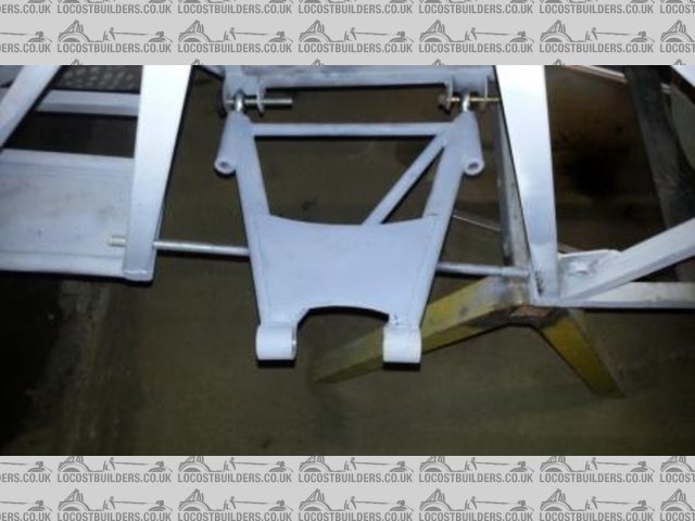

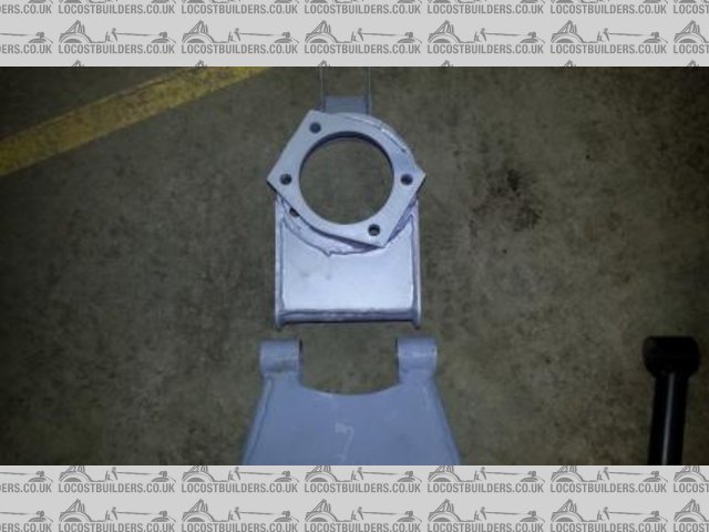

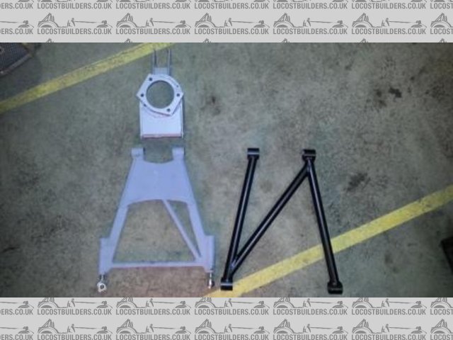

Folks, can I pick your collective brains?
Since my Mx5 based Locost rear end didn't sell, I was contemplating using the rear lower wishbones on the Haynes Roadster, as they are fully
adjustable.
Can anyone see a problem with narrowing the lower mounting hole to make it the same as the Mx5 hubs?
It'll also give me a nice platform to mount the damper from.
  rear wishbones1
  rear wishbones3
  rear wishbones4
Regards Dan.

I would chop the hub ends off the MX5 bones, weld threaded sleeves and run rose joints either side of the hub which will allow you set set toe on the
hubs.
Do not forget you will have a big half shaft running above the plate so you will need to stagger the shock absorber.
Keeping the hub bracket wide provides better location, work around this item.
Regards Mark
