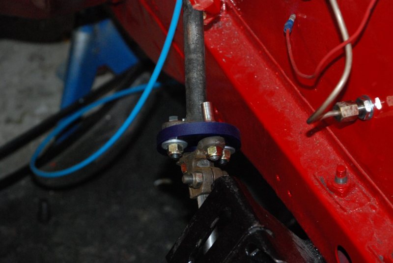

RSr
| posted on 1/1/14 at 11:26 AM |
Like this?
baz-R
| posted on 1/1/14 at 12:06 PM |
yes just like that
CosKev3
| posted on 1/1/14 at 03:45 PM |
quote: Originally posted by RSr
Like this?
did the original bush set up have the long joiners that go from one bolt to the other under the nuts/bolt heads?
Mine has on the one I've just stripped, and I'm pretty sure they help with spreading the load on the bush.
something doesn't look quite right on your pic, pretty sure the joiners I'm on about would stop the bolts going on a angle like they are
in your pic.
CosKev3
| posted on 2/1/14 at 04:26 PM |
quote: Originally posted by baz-R
yeah I seen basically the same thing but made from poly bush metrial
mine arrived, it is more like a poly material than rubber
Holes need filing out slightly to get bolts in straight, but apart from that easy to do.
CosKev3
| posted on 4/2/14 at 06:56 PM |
Fitted
Didn't like the locking tabs that were supplied in the kit due to the sharpness of them,so put a spot of weld on the nuts instead.
