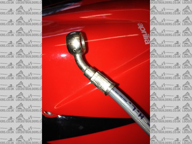

I've bought a set of monobloc brakes for my bike and unfortunately the banjo's on my existing lines are angled and I need straight
ones.
Rather than slurging out on a new set of lines, I wondered about changing the banjo's.
Am I right in thinking that I would have to cut the line to remove this banjo? Or is there a way they the come apart?
I'm concerned that if I cut it and replaced, then I may be a little tight for length.

They look like there swaged on.
You can cut them off and fit a re usable one with little hassle.

Scootz - I can replace the existing unions for a tenner each plus P & P, you would lose around 15mm in length
