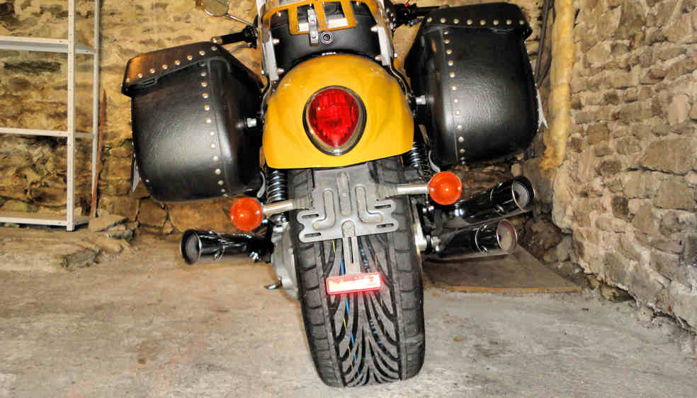

Pat_T
posted on 16/6/14 at 05:25 PM Reply With Quote
It's a very common thing to do in the USA/Australia on the Triumph Rocket III

pewe
posted on 16/6/14 at 06:06 PM Reply With Quote
Pat_T ^^ but that looks just so wrong.
Presumably there are only straight roads in US and Oz?

Angel Acevedo
posted on 16/6/14 at 10:50 PM Reply With Quote
By any chance do you know the Rim Diameter/Width/Tyre Size.
