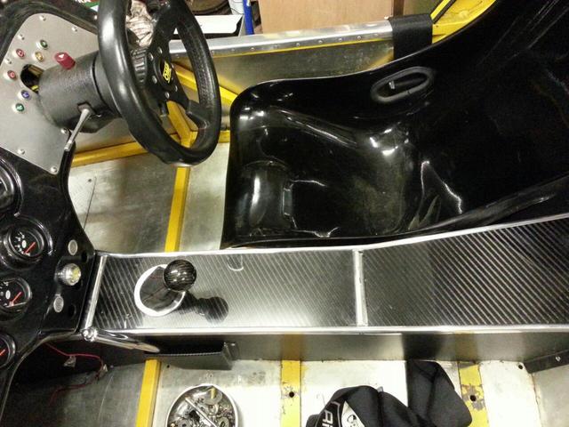

| posted on 11/9/14 at 07:16 PM |
I suck mine on the passenger side just next to the gear stick. Easy to reach and doesn't get in the way this was post iva but as long as you
cover the edges I can't see why it wouldnt pass

The Black Flash
| posted on 12/9/14 at 02:14 PM |
Put mine vertically in a recess in the dash:
Was a bit of a faff though, but it's brilliant when driving. It all depends on how you can get the cable to run really.
