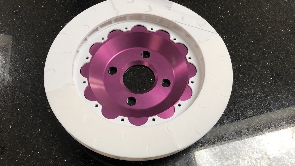

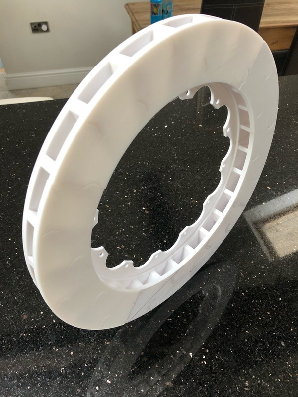

| posted on 20/8/20 at 10:08 AM |
I 3D printed an accurate 330mm rotor to fit my Escort Cosworth bells, will mock up the bracket adaptors I need too before I complete the front end
running gear.
Useful tool for mocking up parts to check clearances and that, hubs still need som machining but the work shop is getting there, once wired and
painted I should be able to get back to the locost in the new year.
