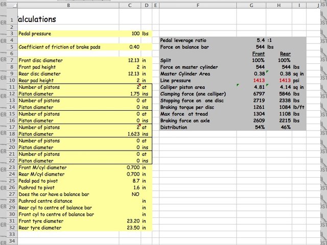

posted on 13/8/17 at 04:31 PM Reply With Quote
This shows the calcs for 2 x 0.7 MC's.
I see the 'Line Pressure' has come up with red text (indicating a warning). Is 1413 psi really too much???
