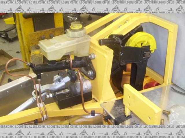

Mark Allanson
| posted on 13/1/05 at 08:04 PM |
exactly the same as James
