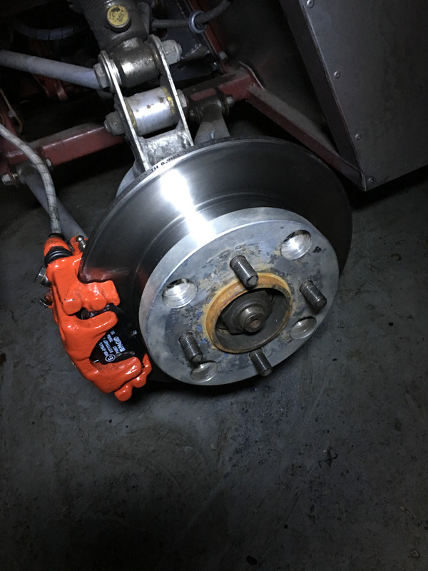

Hello, after having a play this evening fitting my calipers, is it okay to swap the inlet and the bleed nipple over as I’m unsure which is which and
just used the cleaner face for the banjo fitting,

I have noticed in general the drillings for both inlet and the bleed screw is the same and seem interchangeable. Usually you'd put the bleed
screw at the top. What you show in the picture looks fine, why are you considering changing things?

And for the calipers in the picture I’ve actually changed them around swapping o/s to n/s because the handbrake cable wouldn’t have it, the nipples
are now underneath but I’ll take the calipers off to bleed it, I changed the inlets over as one face was more pitted and wouldn’t seal on the banjo
washer

If the calipers can swap from side to side, that’ll put your nipples the right way up with the good faces for the banjos.

Only problem then is that the handbrake cable won’t reach at the awkward angle, don’t have a problem bleeding them off the car, just wanted to be sure
I could use either port.
Thanks again.
