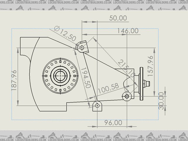

The diff has a short bolt on each side and 2 through bolts and I want to make up a couple of plates to hang it from - does anyone have a dimensioned drawing or plan of the hole locations or know where I can find one?

Here you go :
From a CAD model of the Sierra diff. Measurements match perfectly with Haynes Roadster differential mounting plates measurements from the book.
Hope that will help

Thanks guys, that's exactly what I needed.
